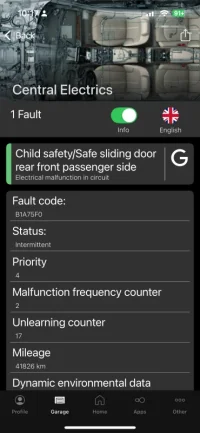

Hi everyone,
I recently did a full scan with obdeleven pro on our 2020 VW T6.1 Multivan and this error came up.
I tried to google the fault code, the error description etc. but so far no luck.
Also I not sure we even have child lock on this door (but I might be wrong, we bought this car recently). Again I tried to google how child lock should look like on this model, but I am guessing it would be where this oval plug is. The door has soft close.
Also upon closer look I noticed some oxidation on the door contact. Is it an issue and if so how should I clean it?
Lastly I cleared the errors (there were others during initial scan) and this is one came back during the following scans.
Any ideas/suggestion on how to fix this issue are appreciated.
Thank you in advance.
LD
