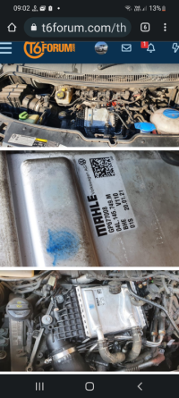

Once I returned home I had a closer look and noticed some bolts are missing and the cooler is only held in by 1 bolt and I was able to move it!!
I then got in touch with the garage and as requested sent some photos, I heard nothing back from them until I rang them the following day. They assured me this is completely fine!
I then drove back to the garage, opened the bonnet on one of their vans and it had all the bolts in there
When I spoke to the technician and pointed this out using my photos and their van he assured me this was still correct and it’s a different engine! But why have the bolts threads there in the first place?
On the photos you can clearly see where the bolts should be and that it’s slightly cleaner as if there was bolts there in the first place!

You don’t want ‘fine’. VW chose to design and spec those fixings so they should be present.
I would also get them to clarify what has actually been changed - I smell a rat! In my experience and what I’ve read, generally EGRs get a flush under warranty and changed when the customer is paying.

The piece you indicate is the charge cooler, not the EGR cooler. The EGR Cooler is on the right hand side of the block (if looking under the bonnet). Which part did they change? Photo of my charge cooler attached.
Here's mine...
Here's mine...
