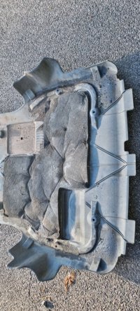

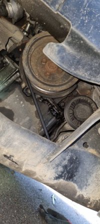

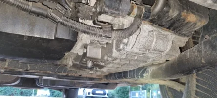

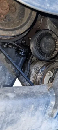

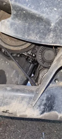

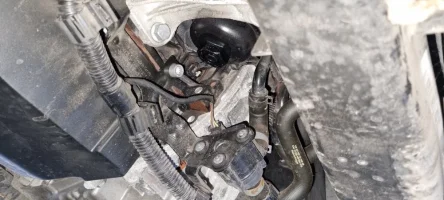

However, on the drivers side of the engine (behind the timing belt) seemingly the sump seal, it is a bit oily on the one side. See the pics. Apart from that, the engine is pretty clean (i dont think it hasn't been cleaned up for sale, it wasn't immaculatley clean). The engine tray didn't seem oily at all, so it's not some horrendous leak, but I keep asking myself why was/is the oil level high?
Si I'm trying to work out if this is a small leak, or just drip off from a wobbly hand when pouring oil in. And is it something to be too worried about, or expensive to fix.

It is of course possible that the oil has been over filled, but it is also possible that unburnt fuel has found its way into the sump and diluted the oil, adding to its volume.
This is not uncommon and it's not restricted to VW engines.
Have a read of some of these threads for a better understanding of oil dilution;
Oil on and around the oil filter housing wouldn't worry me too much, it's likely just left by whoever did the last service.
