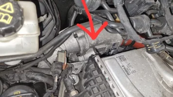

I'm looking in the engine, and my current 2019 T6 Combi (which is 150bhp) has the single black pipe here highlighted in blue (first pic).

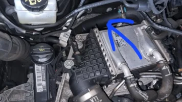

But the 2018 Velle (second pic) has the metal pipe seemingly splits in two (BitTDI?) Highlighted in red.

From the pics i shared, I know the first pic of my T6 Combi van (black rubber pipe (highlighted in blue)) is a 150 BHP engine.
And to me (and as Dellmassive suggests) the second picture with the silver metal pipe that seemingly splits in two, looks like the 199 BHP BiTurbo engine .... which we are trying to avoid for obvious reasons!!
