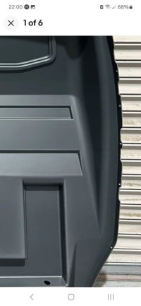

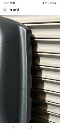

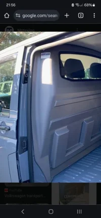

I still want the bulkhead though. I like the Motexion bulkheads but am reading they are for vans that were manufactured without a bulkhead. I think I understand the difference in fixing where OEM bulkhead attaches to additional welded brackets and the Motexion style bulkheads have side fixings because there are no additional brackets. I don't want to do the bracket delete.
After studying some pictures of the Motexion bulkhead and before contacting them I am wondering if.....
1. can I cut off the in turned edges and screw this bulkhead to my original brackets?
2. Will the Motexion bulkhead give me the same extra room needed for the extra 10⁰. Pictures seem to suggest maybe?

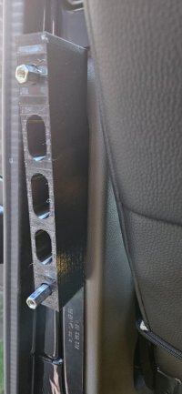

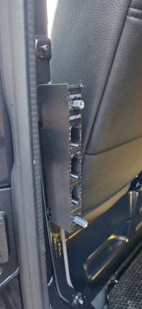

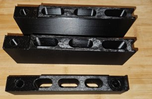

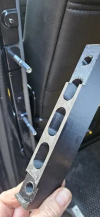

In the meantime I have temporarily fitted the bulkhead back partly with a method someone on here mentioned where they used long nuts. I did some 3D printing to make some infill blocks. All temporary at present. The bottom of the bulkhead is not spaced and joins to the original position with the panel slowly angled away. If I continue with this method I will probably make some one piece long nuts myself as I am not keen on joining several.
20240210_172819.jpg20240210_172606.jpg20240210_162248.jpg20240210_162230.jpg20240210_162240.jpgCapture.JPG

That is interesting about you having a motexion and replacing it with the OEM. All the info I can see on the motexion shows it being fitted to a van that wasn't built with the bulkhead option as they don't have the extra mounting flange around the floor and sides. I've seen pics of the sides of the motexion where you screw it into the sides of the cab. The steel OEM style screws from the back to those brackets. How was the broken one attached?
Ideally i don't want to grind off the lower brackets so if they use the same mounting solution as the steel OEM I would consider using a motexion. I would just need to get measurements of depth to accommodate my new recline position.

You're correct, Motexion is for vans that's didn't have OEM from factory and mount directly to the body.
My van didn't have any of the brackets but as I wanted the bulkhead for security reasons, I just added the brackets and bulkhead for the upper part only. Didn't fancy welding brackets just to cut them off later on lol
