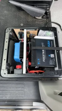

You will be lucky to get a battery and ip65 under the seat if there is ducting there too. I had the same issue so put the battery and DC-DC under the single passenger seat and just the iP65 under the drivers seat. Mine is connected via the quick release connector which is permanently installed and a normal plug into an extra socket under the seat so I can remove it if I want to charge other vehicles. To be honest it will be rarely used as I don’t need EHU now I’ve got lifepo4 and solar. It’s very liberating not needing EHU and makes site selection infinitely more flexible.
Pic of under passenger seat:

Ah, cool. Forgot you had said that! Should be no problem with just the battery and ducting under the seat. :thumbsup:
