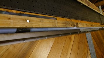

I store a lot of event gear (PA lights etc) in mine and the strategy I use is this:
Seal most of the obvious leaks. I added a wooden batten holding some leatherette type material flaps across the up and over door that seals the big vent.
Use a dessicant dehumidifier with continuous drain. Luckily I have a sink. The compressor ones really struggle in low temps and the mild heating of a dessicant version helps as a frost guard.
Use a simple clip on fan to keep air circulation up. Damp tends to happen where air sits still and can condense. It also helps spread the dried air from the dehumidifier.
The chemical damp absorbers don't do much in a large space like a garage, at least not for reasonable money. But they are excellent at keep enclosed spaces that extra bit dry. So I have 2 big ones in the trailer as that's full of canvas/wood/iron/wool re-enacting gear.
This approach has kept gear safe in the garage for over 10 years for modest amounts of electricity. The simple clip on fan needs a drop of oil on it's motor axle every year as otherwise it stalls but that one has been running for about 4 years now 24/7. It helps it's super simple just a synchronous AC motor.
