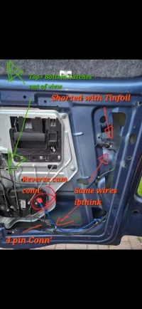

So a bit of messing about, I found that there are wires running from bottom latch mechanism and top latch mechanism on the final closing barn door. I also found by disconnecting the twin wire - think brown and white- and shorting out the male pins side - this fixed the dashboard indicator, so now rear door will always show as closed and my interior light now works properly with other doors. So a temp fix- will it ever get a perm fix ?
So it looks like the top and bottom latches are wired together and presented via the 4 pin plug as the brown and white wires in the pic attached.
It might help others. Vw T6 2016 T2 8model.
