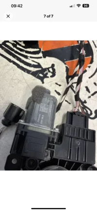

Here are the window motors and loom numbers and here is my bcm number do u think there compatable to wire up
Bcm 7h0937087p
Not sure if this helps any but this was the only photo I found of my looms, labels zoomed in
