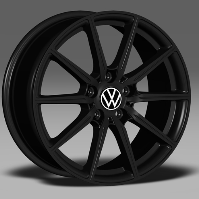

Welcome to the Forum buddy.
I have Wolfrace alloys and have to agree as most of their range is black with Diamond cut highlights which when kerbed ruin the look of their wheels. Mine are no longer diamond cut as had them powder coated.
You could look at Alloy Gators if/when you find a set of rims that fit the bill.
Before and after images
