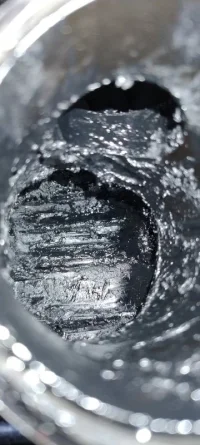

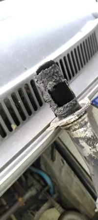

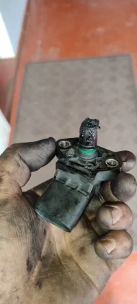

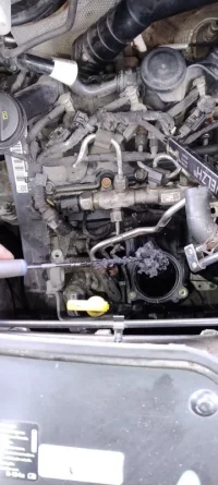

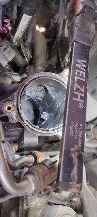

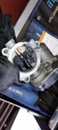

So, after some recent work to my 70k mile 2019 T6, the follow build ups (see enclosed imaging) were found. Can any members point towards the reasoning behind these. The build up removed was thick, black and very sticky.
I would like to point out that I've owned this T6 from new and the engine maintenance from a mechanical point of view has been meticulous. Oil changes every 8k, only has decent fuel put through it. Oil sensors changed when require, renewed glow plugs, occasional engine flushes etc etc - Why? because I can.
Any help/view points will make interesting reading Im sureshot 8.webpshot 2.webpshot 7.webpshot 4.webpshot 5.webpshot 1.webpshot 6.webp

EGR
Get it gone, it’s shortening the life of your engine
The job of the EGR valve and cooler is to reduce the exhaust gas temperature before recirculating it back into the cylinders.
Unfortunately this means that any oil carbon residue is likely to recondent site and get stuck there.
Having the EGR changed it's a common thing on the T6 but normally requires doing every 30 to 60,000 miles. (Depending on your driving style, ia City drives it will clog up faster, motorway drives it will last longer)
They can be removed in cleaned but once blocked you've got next to no chance of cleaning them.
It's a 600 lb part on £1,000 job...... Unfortunately part of the emission control system and a common thing for most modern diesel engines.
thanks so much for the detailed response. I'll get that job undertaken
