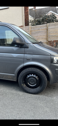

Caps fit fine. Here are a couple of 3/4 shots. They are 8J so slightly wider than Amorak steels and the centre rim sets well inside the wheel rim. Mine were seconds and a bit short of paint in the seams but I topped it up with Hammerite smooth black paint and you wouldn't know. I'm running them with Accelera PHI 255/45/18 103XLs. Plently of rim protection and I ran these on my previous van and really liked them. I was going to lower the van but I've accidently created a mild swamper look that I'm liking at the moment!

Hi Roid86, might be a bit late with this. Just fitted JBW Roks on my T6.1, swopping from standard 16inch Clayton's, no problems. Used the existing radius bolts. Chuffed with the result.IMG_20241109_154044_174.jpg
