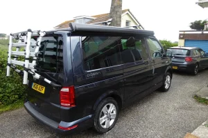

Another flaming set of scratches on the bonnet! Been fine for over a year then in the last week a load appeared on the side of the bonnet, now some on the front lower edge. Can't work out how they were caused - wondering if an animal has taken a fancy to it! Luckily I have Chipex on the way...

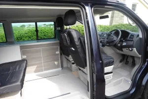

Anyway still gave it and the other car (I won't mention the name of it in case it upsets @Fish :whistle: ) a damned good cleaning. Looking quite good now I reckon. I removed the "homely" rugs we use in the living area for the clean - plus the rubber foot mats one of which has slightly ripped (drivers side, where the clutch foot rest is - ARGHHH!!!!)!!

Must say, good effort keeping the light coloured interior clean mate.. far better than I could..
Well the Chipex paint is currently drying. Slightly nerve racking on such a new van but the colour match looks perfect.
Will do before and after photos if it works out okay...!
One tip... Wet a finger and wipe the scratch, if it disappears momentarily, it's a light scratch in the topcoat (lacquer ) and will probably buff out with compound.. (Gently).. If not, it's a repair..
Yep these are quite deep. Convinced they are from a dog or cat jumping up but no idea when it happened; both very recent though.
Looks good on the picture, very scent color match.
However me personally I would have wet sanded them then polished first. Lacquer in these vans are quite thick.
