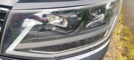

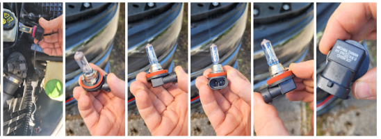

Is there a thread or video anywhere on how to change light bulbs for these please? Am struggling and before I really start yanking stuff or unscrewing bits of front trim, i thought I'd have a check on here. Standby for photis
The right light that seems dim is a standard bulb and the left is an led I think. Am gonna have a look see if I can get a matching set and just replace both rather than trying to match one of them.

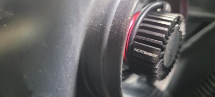

I thought I had THQ V1 lights... I did as suggested. Bought a set of THQ LED's and was very excited to install... the 121963 H7 LED Canbus were beautifully packaged, a premium product I'm sure and reassuringly expensive... but it turns out my lights aren't genuine... the recess for fitting the bulbs was all wrong and even the plug for connecting was wrong. I wrote to THQ and despite advising the van was brand new to me, that I was new to vans and asking for their help, their sales manager was quite condescending in his response. I have since returned them and hope to avoid THQ in future.

I was surprised... i thought they might have offered a bit of advice but all I got was
'we can't make it much clearer for customers, but the bulbs where only made to be compatible with THQ lights, I can see from your images that you do not have them installed to your vehicle'

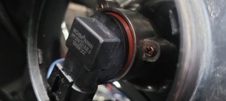

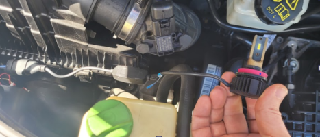

I'm at a loss with these stooopid lights...
I have two different lights in my van and had hoped to find a pair that I could just stick in but it's impossible.
I have the LED one that I can't find an equivelant of like below
And I have the halogen one that I can't find the equivelant of below
If anyone knows anything I'd appreciate some insight
