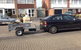

Years before I had the budget for a VW van, I had an Erde 142 on the back of my old Astra. I could get the hatchback car and trailer into our local tip where a van (even a privately owned Kombi or camper) is not allowed :whistle:
The trailer was well made and I really liked using it. Unladen it did bounce around a fair bit but was stable with some weight in it. You could also get extended sides/front/tailgate to increase the depth by the same amount again.
Halfords had them on display to take a look at and it came flat packed :thumbsup:
