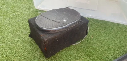

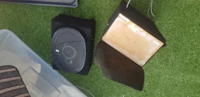

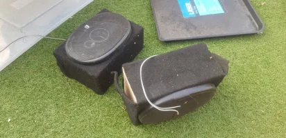

I've made up single speaker boxes . . . With 6x9 speakers in for my old work van as it was a lease hire.(you can put them wherever you want)
I just wired them in on a temp loom... to they could be removed quickly when needed...
Just an I idea for you..
Funnily enough I'm sitting infront of them now...
These must be over 15years old now . . . . !!!!

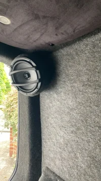

They can be mounted in the ceiling
Think ceiling mount could be the winner! Now what speakers? What build height can i get away with?

I fitted mine in that location and fixed to the OE hardboard roof panel, the weight of the speakers will try and bend the panel a bit if removing/refitting the panel but as they are nearish to the edge the factory fixings and joining strip hold the panel securely enough in place
Can you mount these to the original roof panels or do you need ply lining and then self tapers or do you use m4 bolts and nuts?

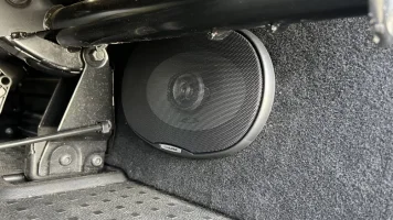

Mounted in the positions in the picture is quite a solid service,
Using the supplied clips and screws, they won’t move or sag as speakers are quite light

There is a compromise between aesthetics and sound quality to a degree with these pods and there is air volume behind the speakers. Due to the nature of frequencies the speaker handles you don't need anything the size of a sub enclosure.
Also I wouldn't put speakers in a box on the floor. The only thing that will benefit is your feet. The sound waves can't travel cleanly to your ears due to how low they are and also there's so many different surface down there such as your legs and fixing points for the other seats.
When we do custom door builds the woofer in the doors get angled upwards to project the sound into the cabin like what we did with the demo/sponsor van we did seen here it's not a criticism of your install or thoughts by the way just an observation.
