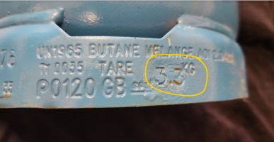

The empty weight of the bottle is pressed into it somewhere.

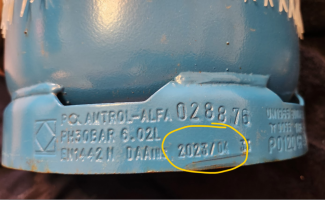

looking at the new 907 from yesterday. . .
it shows 2023/04 - assumed production date, for the 10yr life cycle.
po30Bar - pressure?
6.02L - volume?
the the next bit shows:
TARE: 3.3Kg - Empty container weight.
it also mentions UN1965 Butane
and assuming this next one details the max fill level?
A01 2.94Kg.

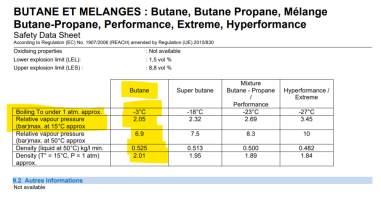

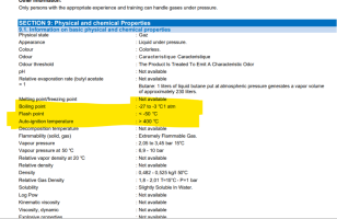

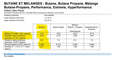

a nice COSH data safety sheet here:

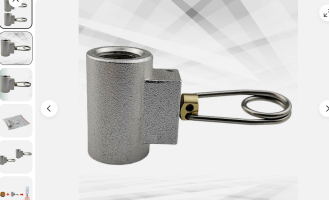

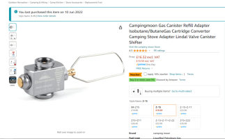

you need one of these dodgy as you like refill gas can adapters. . . - 2 Pc Gas Tank Fill Can Inter-fill Propane Refill Adapter Connector | eBay

i bought this one too - https://amzn.to/3y9SInb

at that point i moved over to the twin C500 gas adapter from CADAC, which was great. . . - https://amzn.to/4bw0kyP

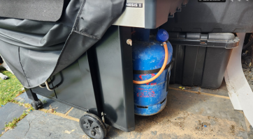

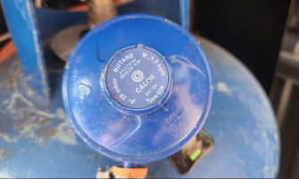

I've still got it - the 15Kg Calor gas bottle.
its on the Gas BBQ, i was running the bottle down to get rid of it as i have a few other Propane bottles. ( Red Regulators )
but its still there. . .so i can start using that, then get a cheap 15KG refill.
to then top up the 907`s.
looks like ill be keeping this Blue bottle after all.
