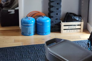

Once again with various prices around the country is this not a case of filing your own?? plenty posts on what equipment you need to do it with success .It's not a new thing to decant from one bottle to another .done it for years decant propane from the bottles at work also pure argon for our home tig welders which is a bit more complicated because argon bottles have a non return valve. Just think as filling your butane lighter same principle.
Just filled my 907 bottle for my cadac cost approx £2:50

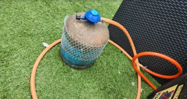

Following Summer Camp, just refilled our 907 with 1.5kg from a 15kg Calor bottle. Not a difficult process with the correct gear from B.E.S. 98% full, it will last our Scottish trip with no worries now.

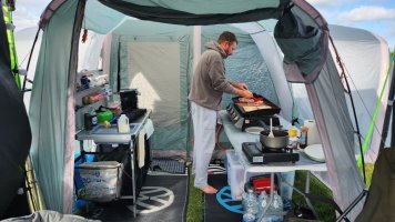

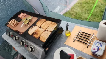

Looks like my bros 907 has lasted him for about 2 weeks of camping days.
Running a 4 burner Planchette hot plate thing.
Not bad for a £15 refill.

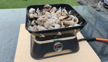

i have a question for you very clever Gas knowledgeable people. . .
we have one of these from Costco from the other month,
finally come to give it a test run.
i want to run it off a 907, as i have a few spare and its more convienient.

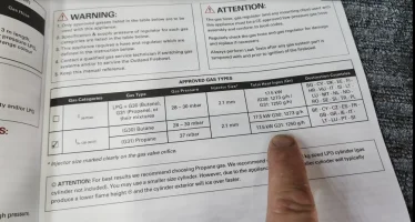

i checked the book,
it says Butane is ok at 28-30 mBar,
and i checked the Reg` and it shows 29mBar, so thats a match.
the issue and problem seems to be that the 907 is freezing causing low pressure and flame out - not good as its not got a saftey shutoff.
the books shows a burn rate of 1273 g/h.
so whats the max g/h the 907 + reg can do?
is it the Mg 0.8Kg.h @ 29mbar? - on the Reg?
if thats the case then maybe the 800g/h cant keep up with the burn rate of 1273g/h?
there is a high and low setting on the fire pit. . so ill try the lower setting.

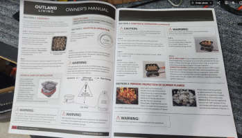

i checked the book,
View attachment 257289View attachment 257290

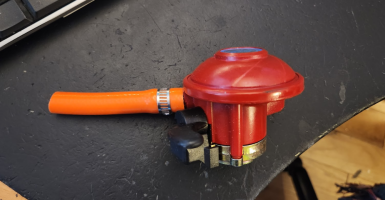

best go check the RED Propane reg that it come with to check what its flow rate is?

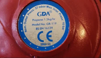

this is what it come with. . .
and looks like that reg can do 1.5Kg/hr,
thats 1500mg/hr -- so more than enough to keep the heater going full steam.
looks like if i want to use the 907, ill just have to go easy on it and keep to the low setting.. . .
basically the burner can use gas faster than the reg can deliver it.

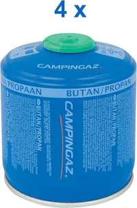

so we got the converter adapter and uses these C500 cans instead.
  • 'Comes with adapter for butane and propane cartridges with EN 417 thread (7/16 x 28 UNEF)
