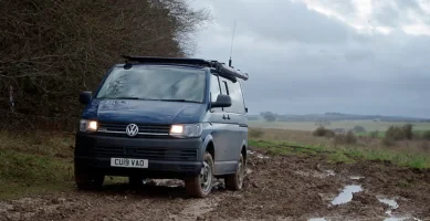

So agree with @Kind of Blue ... when the going has got tough, pressing the magic diff lock button definately feels like it locks in 4wd and really does drag you up or through pretty much anything.
Anyway, if you want to drag your T6 up a mountain...
or across Salisbury Plain gloop...
...then 4mo with diff lock very desirable and occaisionally essential. But otherwise, good tyres and some common sense is probably all you'll need!

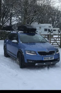

We have run a Skoda (2015) scout for many years, it’s a beast when it’s got winter tyres on.
You can electronically lock the front and rear axles with a press of a button and drive up to 30 kph before it automatically turns off this ‘lock function
I drive over Kirkstone pass regularly for work, I fitted full winter tyres to my FWD Transit work van and have made it over a few times in full on winter conditions, but I would probably have of got stuck if I had to come to a stop on the steep bends near the top, you can’t use speed because of the sharp bends and stone walls, I passed a few stuck AWD vehicles Halfway up the pass, obviously on road biased tyres, didn’t want to stop to help as I’d probably get stuck too.
Iv used the skoda on its winter tyres, to tow a stuck heavy AWD Volvo up kirkstone pass in full on winter conditions, the Haldex system is really good, but it’s definitely the right rubber on the vehicle that will keep you moving though.
