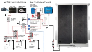

One of my main aims is to integrate with the VW Oceans existing equipment (charger, CCU etc.) hopefully without interfering with the VW control of the battery isolation relay, my real problem is I want to charge both the leisure and starter batteries from one solar controller - hence the argofet/relay combination - it charges both leisure and starter with ignition off, charges leisure only with ignition on and VW isolation relay open.
If I dropped the argofet/relay and connected my solar directly to both leisure and starter batteries I would permanently bridge the VW battery isolation relay with my charging circuit, during starting it would risk the wiring on the charger side being used to supply some starter current from the leisure batteries - and that would instantly blow my charging fuses.
If I just charge the leisure side, then the starter battery will discharge over time while parked - VW isolation relay open - and I don't want this.
I could bridge the VW isolation relay with something capable of transferring starter currents, like a Victron Cyrix battery combiner and just connect the solar to the leisure batteries - I did this on my boat and it worked fantastically - but it would also bridge the VW isolation relay and depending on how much intelligence VW have built into their fault detection may result in fault codes.

So .... I`ve got all the parts (almost) and am going with this ... I know it is unconventional, but as some probably famous person said ... "only dead fish go with the flow"
The main benefit to me is:
When off-grid, all the solar charge current (maxing out at 20-28A dependent on temp.) is available to split between all 3 batteries - and that means all vehicle systems including the entertainment system, the sliding-door motor, the boot motor, the central locking, and all the other things that get powered on whenever you unlock the van or operate something forward of the b-pillars - eg. infotainment system.
If the van is parked an not used, then a 1A trickle charge would be fine for the starter battery, but if parked and used I don't think it will be enough to keep the starter battery charged long-term.

Quick update ... after much faffing I've finally got round to building my Solar Panel for the summer holls. Spent ages working out how best to wire the panels and decided on series as it adds the voltages but keeps the current constant. There are two advantages to this .... first is that lower current means less loss in the wires, and second, you see instantly if one of the panels fails or is intermittent as the voltage halves and this shows up in the victron history too. The shading advantages of parallel are not that great when you already have an oversized array. Anyway those were my reasons.
Solar roof panel looks like this .... glued down and sealed with sikaflex.
.. and the panels are connected in series inside the glued heat shrink ... there is also a XT60H connector in there (a 60A connector from RC vehicle batteries) so I can disconnect and remove the panel if needed.
Now completed "Phase 2" of my installation and for Victron fans, I can confirm that a correctly configured Victron Argofet does indeed enable simultaneous charging of starter and leisure batteries. Installation looks like this ...
Update on the use of an Argofet to split the solar charge between the starter battery and the leisure batteries. It doesn’t work, or to be more accurate, it works if you never drive anywhere.
Seriously, don’t do this on your van – fit a trickle charger to charge the starter. :grin bounce:
I could not understand why I was getting a massive daily yield and poor leisure battery performance from the solar while driving on sunny days, but I think I’ve figured it out.
The Argofet splits the charge between the two battery banks, and the bank with the highest load will draw the most power – great if you want all batteries at 100% SOC quickly, but it is actually a problem in a T6.1.
What exactly do I think is happening ….
The smart alternator/recuperation logic is trying to regulate the starter battery to around 80% SOC, so it can run its recuperation strategies. When the SOC is above 80%, the smart alternator turns off and all the vehicle electronics run from the battery to bring down the SOC. In my case, when this is happening, the solar is responding to the load on the starter battery and the MPPT controller is pumping out as much energy as possible, most of which is going to the vehicle electronics and not the leisure batteries. The alternator is as good as off, trying to get the starter down to 80%, and it isn’t charging the leisure batteries either - unless I switch Max Charge on.
The upshot is that if I leave the van sitting on a sunny day, everything ends up 100% charged and all is good. As soon as I start driving, the recuperation logic tries to run the starter battery back down to 80% while the solar fights to keep it at 100% … I get a situation where the solar is pumping around 11A constantly into the system while the smart alternator is effectively taking the day off. I end up producing a daily yield of around 0.9 kWh, most of which has been used to run the vehicle electrics instead of charge batteries.
This is obviously not working as I intended.
The same will be happening to a much lesser degree with vans fitted with starter trickle chargers, but the effect will be very much reduced as the current produced by a trickle charger is relatively low – but it will still make any solar installation less efficient on a van with recuperation and start/stop.
I’m now looking at putting a switch on the charge line to the starter battery which I will only close when I park up the van for a long period of time.

After much deliberation I am putting a switch on the starter side of the charging circuit so the system now looks like this.
I considered a normally closed relay which cuts the connection on engine start, but due to the 80% SOC target on the starter battery and the smart alternator this means the MPPT will use energy to charge the starter back up to 100%, just to have 20% thrown away on the next drive - because a trickle charger doesn't charge as quickly, the effect will be unnoticeable, with the solar just wasting an amp or so while driving.
Compared to a trickle charger the advantage is that it can put more energy into the starter when it is active, and when switched off, none of the solar energy is being wasted fighting the smart alternator and recuperation strategy.
... the disadvantage is that it has to be manually switched on and off and the solution is more expensive than a trickle charger.
Finally finished the solar system .... what would I do differently next time?
1. The Hess Panel and the solar array stuck down with Sikaflex has been faultless. It has added virtually nothing to the height of the van which was very important to me (as well as surviving car washes) - so I'd do the same again. 310W seems to be a bit of overkill for our use-cases - just run the VW fridge, LED lights, Laptop, Camera, Drone and other USB device charging ... but it means I've got a bit in reserve once I've sorted out Lithium batteries and an Inverter.
2. The scanstrut through roof connection is watertight but I would mount it a little bit further back next time - the headlining in the pop-top is glued to the roof with a 1cm foam sandwich ... routing the wire was not easy.
3. Not sure a Victron Smart MPPT 100/30 was the right choice ... I might have been better off with a 100/20 with its load output (See point 4) and I'd connect a starter trickle charger to the load output.
4. The Argofet was a mistake, I did not fully understand the strategy VW uses for recuperation and the behaviour of the smart alternator. I had not anticipated that the smart alternator would turn off when the solar is generating lots of amps. Interestingly on the German site which is advertising a fully integrated Lithium solution for a VW T6.1 (with re-programming of the CU) they made some interesting comments (in German) about the VW system in the latest vans. Apparently it keeps all 3 batteries at around 90% charge, and before you intend to camp, you should turn on "Max Charge" to get them (all 3) to 100%. The "Max Charge" function will end when the batteries get to 100% or the next ignition cycle. This makes sense because by using "Max Charge" you are turning off recuperation and start/stop and raising the idle speed, which affects CO2 and fuel consumption. I solved the problem with a switch that enables starter battery charging from solar if I leave the van sitting for a while, but it is not the fully automatic system I envisaged.
