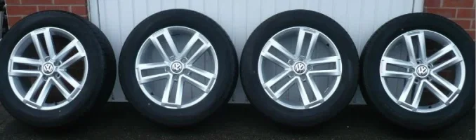

Just fitted these tyres to a set of Amarok Cantera alloy wheels to keep the rolling radius correct for my T6 and the garage have them at 35PSI, which seems a little low?

Love those 19" Amarok wheels, have you got any photos?

The only photo I have is with the original 255/55/19's, Bridgestone Duelers HP sport 111H tyre , as fitted originally when on a Amarok.
I dropped really lucky with these, buying them brand new after a new Amarok owner wanted 21" alloys, so these came off at PDI when at the dealers.
The original tyres still have the dimples on them, they have probably covered no more than 5 / 10 miles at most - I really need to get these sold to pay for the new tyres
The new wheel / tyres are eagerly awaiting fitting in April when the sun starts to shine...
