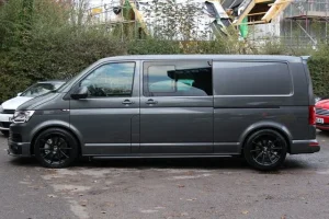

This has 21"s which don't look any different to 20's in my opinion.
Thoughts?
Again, it's personal choice. I just think they look out of proportion with the rest of the van. If it was on air, and they tucked under the arch, they'd pull off the look perfectly, but slightly lowered on 21" wheels just looks like a van that's had aftermarket wheels whacked on with little thought of the actual look they want to achieve. Some people might love that look, but it just looks wrong to my eyes.
