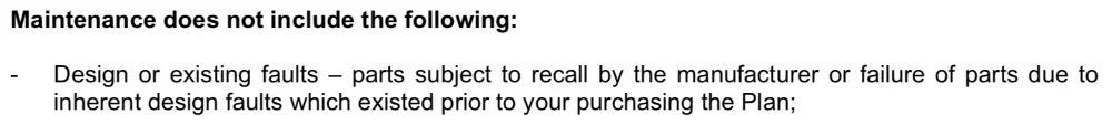

It’s confusing tbh - paperwork states that the parts are covered (provided not deemed normal wear & tear), yet it wouldn’t be covered if defined as an ‘inherent design fault’ (as per the pic).
Warranty also states it must be maintained in line with manufacturer recommendations to be a valid claim - although maintained as per recommendation since I purchased the van (& therefore when the warranty began), the prior service history is patchy at best.
Will submit a claim regardless, as it can’t put me in a worse position than I am now!

Yes - either RAC say it’s a known design fault in which case you go to VW and basically say ‘these experts tell me this is your problem to fix’ or they say the van wasn’t previously maintained to the correct standard in which case you go back to the dealer and say ‘you sold this with a warranty that was never valid - which smacks of mis-selling’ and ask them to rectify the issue.
If the RAC won't put it in writing  and be prepared to appear in court to substantiate their opinion then it doesnt matter what they say.
We know theyre right, but VW won't roll over just on someone's word.
