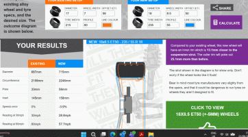

Im in the process of changing my standard 17x7 devonports to a 18 x8.5 wheel current tyres on the devons are listed below currently on 215 60 width and changing to 235-55 my question is, will there be in issue at the back I've measured wheels centres after my new suspension has been fitted so 420mm from centre of wheel to arch front and back and measure the front arch and plenty of room to accept the wheels and tyres front wise however, at the back i have 40mm clearance to the right internally and 60mm to the left internally and 90+ to the wheel arch and plenty internally, just wanted to know if anyone had any issues before i press the button on the tyres , and im aware of the -3.9 speed diff that this may cause

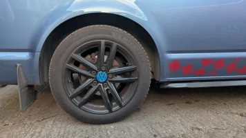

Also on 18x8.5s, 60mm lowered, 235/55, 20mm spacers on the rear to bring 'em out level with the arches, can't remember the ETA but they're Calibre 5s. No issues.
