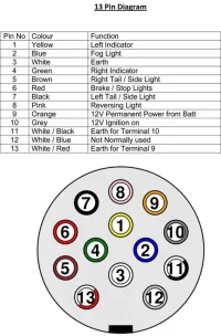

You will likely find that the yellow wire is pin 10 and the brown the earth on pin 11. You need a relay and associated wiring to connect.

westfalia is additional kit yes and yes i assume the 10pin is additional from vw even though its present at the socket. you could confirm this with a multimeter to continuity test pin 10 and 11 at the socket with your yellow and brown/white.
