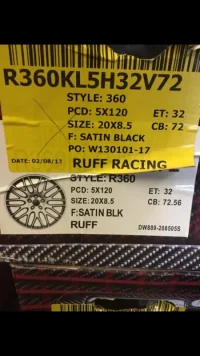

I have the opportunity to get these today before I waist my money will they fit?
4x 20x8.5 ruff racing wheels
USA IMPORT WHEELS
5x120 +35
BMW
Vw t5 t6
And more
Any questions please ask
They will fit yes.
I ran 8.5" ET45 and there was plenty of room for more offset either way, so they will fit, but as above, just need to know the load rating to make an informed decision.
many thanks pal
You can get adapters to make them fit, but they also effectively change the wheel offset too. Looking at the offset of those wheels you’ll be starting to have trouble clearing the outer arches if you use adapters. I would look elsewhere bud.
W
will do. Appreciate the help
