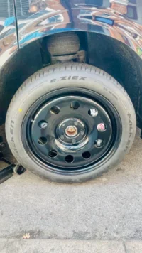

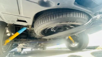

This fits over the big brake kit (AP Racing 6pot Callipers and 390mm discs by Plush Automotive - highly recommend these guys and the kit) - and, crucially, it fits in the spare wheel carrier under the van without any modification.
The tyre is the crucial part, so it fits in the hanger. I have a 215/50/19 on the steel wheel. (same width and very close circumference to the standard wheel)
The wheel clears the brakes with the 20mm hub adaptor, and there is just enough clearance on the wheel arch to use it in a 'get me home' scenario.
