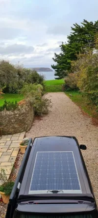

I’ve got a 1345 (L) x 665 (W) x 4 (D) mm 160w semi-flexible panel on my pop-top. Would have gone bigger, but they weren’t in stock and I gave up waiting.

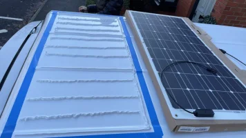

Go as big as you like providing it doesn’t hang off the sides. Or put it on across the roof like mine(to keep out of the way of a roof rack coming soon)
The obvious answer is to measure the actual roof that you are trying to fix it to - other roofs are not necessarily going to be the same.
