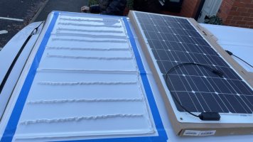

Here is mine in the process of being glued across the ribs on the poptop.
Seems like a good solution to the issue of overheating. Would be very interested in more photos and progress updates. Are you taking the power feed through the pop top of through a gap in the door? Also, who makes the panel and what output. Good luck.

The feed goes through a hole in the roof, with a sealed gland, under the back of the poptop (photo at the link). It’s a Renogy panel, 100w. I picked these panel dimensions as it fits behind the roof rack without being shadowed.
