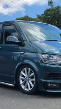

Wheel Identification [Springfield]
I think there are 2 different finishes to the Springfield. Standard / Polished.
The Polished are more expensive.
Can anyone ID them, think the are genuine VW ones and load rated for the t32..
.... where can they be bought from?
Cheers
