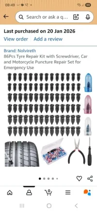

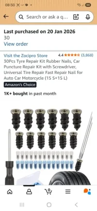

One pack from two different places..
This set..
And this set.
One pack has 3 sizes, the other had 2 sizes...
Both come with a screwdriver, which is rubbish quality as as you would expect.. so I've got a better quality one anyway. (,if it's in the work van I'd probably use a battery screw gun anyway?,)
And one come with needle nose pliers, which again are pants.... Ok for emergency I suppose.. but I've got loads of tools so will dig out a better one.
I made a small mix up bag of all them and have one in each van..... With loads left over.

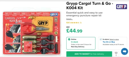

just had a quick search . . .
Gryyp Cargol Turn & Go - K004 Kit​
  • 1x Marker
  • 1x Pliers
  • 4x Cargol puncture repair tools
  • 1x Valve adapter and protective sleeve
  • 4x 16g Co2 cylinders
  • 4x Valve caps with cloth carry bag
Cargol Turn and Go is a unique emergency puncture repair system which can be carried with you and usually takes no more than two minutes to use. Every Cargol puncture repair tool is designed for ease of use and is made up of a fibre reinforced nylon bung with an insertion point and a toric spiral and a handle big enough to make screwing in a doddle.
The manufacturer recommends that emergency repairs should be checked by a professional and that you should not travel at more than 50mph on an emergency repaired tyre
mostly positive reviews of - not used yet, but carry with me.
