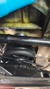

I bought a Bilstein b14 comfort kit a few weeks ago for my t30 4 motion, not sure I've done the right thing.
I've only fitted the rears as of yet and this is what I have, so not fitting the fronts. I adjusted the springs to give me more height as it is a campervan and a 4 motion, so a bit heavier. I would like more height and there is some adjustment left but at this point the springs are already rubbing together.
I'm really not happy with this. So really you can't actually adjust from 40)70mm without the spring rubbing together.
This is very poor imo, so really the spring set up is not fit for purpose.

All too often we see this problem .
Transporter 4 motion Camper is the heaviest van there is and these kits can not carry the weight with in their designed lowering range !
We have seen these kits at full height adjustment sitting 90 mm lower than standard . That tells you the springs cant cope .
