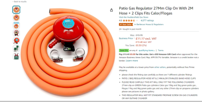

I thought I’d need this: Cadac 37 mbar Propane POL Overflow Regulator QR | Cadac UK
The cadac one will work, as will the second of @Dellmassive links, but with that one you would still need to connect to the cadac via some sort of adapter. If you have a hose to the cadac already, you could split that, put in a QR connector, and then have the option of using different cylinders & regulators.
I’ve got the option of running on camping gaz, propane, patio gas or c500 cylinders with this method
The CADAC 2 Cook 3 comes with the QR (quick release) adapter installed already - if that’s what you mean?
Yes, the male fitting goes on the appliance, then put female connectors on the hose from the regulator, as they have a cut off built in if it comes disconnected
