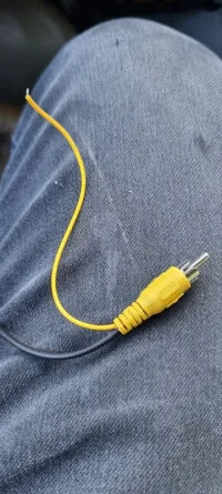

K KevTwopines Member 17 May 2025 #1 Hi Folks, Apologies for asking.. but what's this yellow wire for please? This is a reverse camera connection (the instructions aren't clear enough). Is it an earth? Best regards
Howzat Senior Member T6 Legend 17 May 2025 #2 The yellow wire is usually a trigger wire to tell the display to show the image and is normally wired to the reverse light wiring.
K Kind of Blue Member T6 Legend 17 May 2025 #3 Howzat said: The yellow wire is usually a trigger wire to tell the display to show the image and is normally wired to the reverse light wiring. Click to expand... so if it was permanent live with ignition on one could have permanent rear image or use another switch to watch what was going on when one choses.?
manfrotto Senior Member T6 Legend 17 May 2025 #4 Kind of Blue said: so if it was permanent live with ignition on one could have permanent rear image or use another switch to watch what was going on when one choses.? Click to expand... That would work. I had a rental truck and it had the reversing camera wired like that, so it was like a rear view mirror
