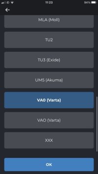

What is the Difference between vao and va0

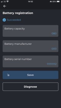

I guess it’s just a typo but It doesn’t really matter anyway, the most important thing is that the capacity is correct, as long as you enter a new serial number (it can be 123456 of you want) then the vehicle knows a different battery has been installed and resets the charging regime
