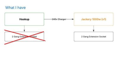

I have a fairly basic electrical set-up in my Caravelle that I'm trying to simplify even further. In short, I have two 2-gang sockets, one plugged into each power source. I want to have a single 2-gang socket with a simple switch to allow me to select between my two power sources as below.
My Google skills are letting me down as I can't find a simple switch that allows me to flick between hookup and battery. What is it I should be searching for

Aren't you over thinking this?
The 240v outputs of the Jackery remain on when the hookup is connected and when the hookup is disconnected.
So just use the output of the Jackery and it will either be on hookup or battery dependent on whether the hookup is connected!
(Unless your Jackery works in a substantially different way to my Ecoflow!)

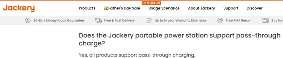

As I suspected - from the Jackery website:-
You need a transfer switch.

From what I have read, the Jackery does support pass through, but the recommendation is to keep the output lower than the input (or vice-versa, electrics are really not my thing :D )
I'm definitely overthinking it :D

It cant be true passthru as it doesnt have a mains input
I assume they mean it will accept an input/charge while outputting 240 ie never go flat as long as the supply is greater than the demand ?
