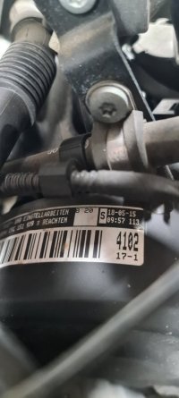

Also could you please take/post picture of your EGR cooler sticker - next to oil filter - it looks like this (size approx. 4cm x 2 cm):
cfca-rev_d_-b-_20190610-jpg.119785
This is mine...
QR code spat out a number a follows :
03L1155120000151140012lll87027560900

This is mine...
That looks a pre-REV D EGR cooler for a CFCA. Not good news.
Hmm... The EGR (cooler) issue before version "D=good" was only on engines (code CFCA) built before approx. mid-2015.
Actually I'd expect to see a totally different engine (code CXEB, also known as 204PS engine) in a 2017 van - the engine code is on configuration label (under dash). Or just post a picture of the engine.

I believe that VW have replaced wrecked engines but may not have admitted there is a issue that requires recall.
If your engine has 59000 Km under it’s belt the Rev C EGR cooler may well started the cylinder wear.
You’ll soon know as the oil consumption will be excessive. For reference I have a CFCA and I‘ve never needed to top up the oil.
If oil consumption and cylinder pressures are good I would consider replacing the EGR unit with Rev D.
