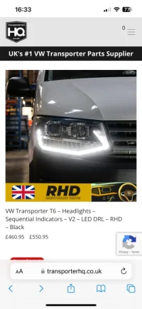

Just wondering if anyone can identify these aftermarket headlights?
they are going fairly cheap on FB marketplace. Apparently tly have come off a 2017 T6.
I thought they maybe look like THQ V1s?

look like the version 1s. They way to check is the v1 has standard indicator and the v2 is sequencial
THQ sell LEDs that fit in their headlights and don’t throw up codes.
Got them in my V3’s. They work great

The THQ lights all have LED daytime running lights (DRLs) as standard.
They’re the long strip running below the indicator, curving up at the outer end.
They should light up white with ignition on and stay on, but dim when using headlights.

Hopefully you’ve found dipped and main lamp details from THQ, including LEDs?
They do their own H7 LEDs to go behind the dipped beam projector.
You’ll need to source a good quality H1 LED for the main beam reflectors and you may need resulting lamp failure warnings coded out.
Be aware that aftermarket LEDs fitted into headlights designed for halogen lamps are technically illegal and may fail an MOT.
