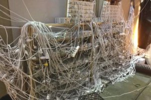

- I tried to trace the volt drop back through the wiring and learnt it pays not to did too deep into the work that supposed professional conveyors undertake. Example, I have a dedicated fuse on my Sargent Unit but for some reason this muppet decided to add another inline fuse hidden way behind a screw on panel. See pictures of said wiring.
- anyway, long story short, borrowed a mates new leisure battery and boom away it went. So back to post #1 here, so thank you.

DC voltage drops as the cable length is increased, the photo shows not just a complete mess but enough spare cable coiled up to wire a fleet of campervans.
Who did this?
Who did this?
Yes agree. I won’t name the converter here on open forum but if you are from the BA20 postcode area, drop me a PM
