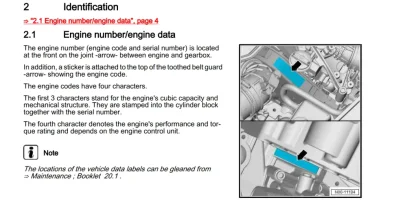

First three letters show engine type and fourth letter denotes the power option.

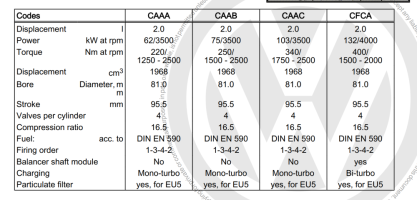

T5.1: (sept 2009 to 2016)
2.0 TDI CR - CAAA 84ps
2.0 TDI CR - CAAB 102ps
2.0 TDI CR Blue motion - CAAD 114ps
2.0 TDI CR - CAAE CCHB 136ps
2.0 TDI CR - CAAC CCHA 140ps
2.0 BiTDI CR - CFCA 179ps - (EGR cooler issues pre rev D)

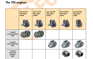

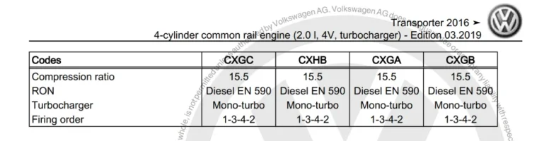

T6: EU6 - With adblue (2016 to 2019)
2.0 TDI CR - CXGA 85ps
2.0 TDI CR - CXGB 102ps
2.0 TDI CR - CXHB 114ps
2.0 TDI CR - CXGC 114ps
2.0 TDI CR - CXFA 150ps
2.0 TDI CR - CXHA 150ps
2.0 BiTDI CR - CXEC 199ps from 2019?
2.0 BiTDI CR - CXEB 204ps upto 2019? (Engine block issues)

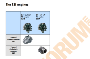

2.0 Petrol TSI - CJKA 204ps
2.0 Petrol TSI - CJKB 150ps
Petrol's with CAT, No DPF or EGR

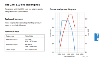

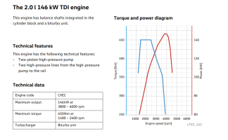

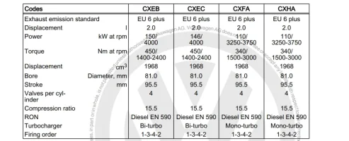

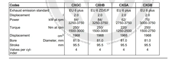

data1
T6 . . . .
previous . . . .
data2
T6.1 . . . .
