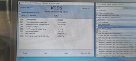

Attached some VCDS readings I'm struggling to find what the actual values should be after purchasing workshop manuals there's not really much information.
I have also reset some of the fuel pressure sensors, the VCDS readings was taken at optimum temps and at idle. Some was taken before the reset of the fuel sensors.

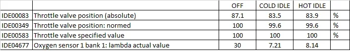

I have noticed the throttle valve position is 83.5% cold and 83.9% hot idle seems quite high tbf but totally unsure if this is normal for this vehicle or not?

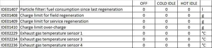

It looks like that at least the DPF is deleted - e.g the data below is very strange. Wouldn't expect them all to be plain zeros. Not even the exhaust temperature sensors report anything (this engine doesn't have sensor 2).

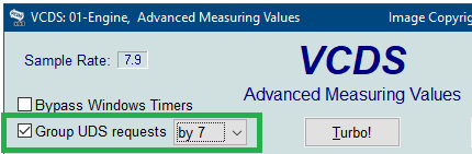

The measurement setup can be saved for the next run - click on top left corner (Save/Load)
Tick Group UDS requests by 7 (or 8, whichever value keeps data alive)
Log > Start (do not forget to start logging!!!)

Is the throttle valve position correct or is that something that could be caused by this?

Ok, the not a clogged DPF strangling exhaust flow. Then obviously doesn't do DPF regens at all - so a distance counter seems to be just a remnant of original software.
On idle the data seems to be as expected - specified=normed.
Also the oxygen sensor reports plenty of leftover oxygen in the exhaust - probably because of no exhaust recirculation - so not restricted there.

I've always thought a throttle body should be around 10% to 18% open on idle. Unless VW do it backwards and it's 83% closed on idle.
I'm highly confident that on these engines the throttle is fully open on idle. Just because it seems to be in same position at higher engine loads.

The butterfly valve on mine is open fully with ignition off just took the inlet pipe off to check. Turned ignition on and it doesn't move.
