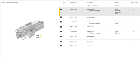

This is the clear image of the buttons, from what i have understood for the top buttons where is the heater for window i think i need to by 7LA 927 211 and i can use the WLAN button for wheelchair unlock but it is not clear for me what is the code for the bottom area where is the MODE button. Do you know what i should search?
Also I do not know what exactly module to search because i have notice that there are some with black/alum or black/grey
could you guide me a little bit please?

There are two styles of buttons, one with the metal strip likes yours which is black/alum and the other type has a black bar through the middle
The parts catalogue is unclear on the bottom buttons which part you require and what it actually represents ?
Do you have any other switch banks with spaces in ? What about the buttons by the headlight switch, any blanks there ?
from the catalog i understand that for the top buttons i should use 7LA 927 211D WZU which is the module with wlan/bluetooth, windscreen heater but for the bottom module i do not see any options that have 2 buttons means MODE and something else...

Hello ... can you share the link to parts catalog?! pls
I use partslink24 but it’s subscription access
Thanks a lot ... but one day access cost like one day in wellness.
I need to check 2 parts ... I'm not really sure with partnumers. (black/chrome)
1, 7LA927202???WHS ESP/MWL
2, 7LA927211K ... is it really "MODE" button like on picture upper?
Yah ... right, doesn't work for my VIN, but I found my model ... I have to chcek on workstation, because small display, but it looks like solution ... thanks a lot
Unfortunately the free version doesn't do the VIN based search.
