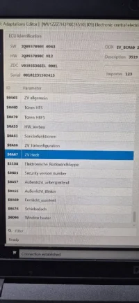

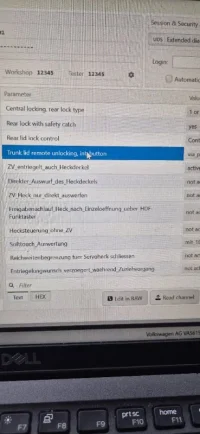

So what I have discovered that in adaptions
ID. 0A76
Parameter. ZV heck
Parameter. Trunk lid remote unlocking, int button
Value. Not installed

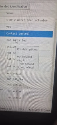

What are your options for that adaption channel ?
I would expect to change it from not installed to installed ?
Thanks for your reply pauly.
So the value options were,
# Not installed
# Via pin (seems common for both vans with and without electric boot lid motors)
#Via remote (assuming possibly keyfob or additional fob for shuttles/caravelle) Looking at saved backups, this option seemed more to transporters that had fully loaded options.
# And unassigned pins.

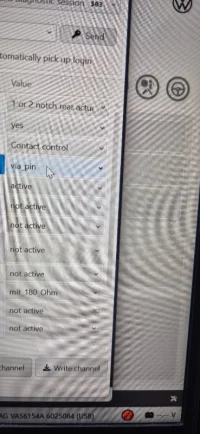

UPDATE###
I have now coded the interior boot lid switch correctly to bcm.
I had to go in to adaptions
Pics show the necessary parameters and value change. This was set to 'Not installed'
Now fully functional
