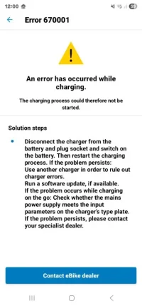

I've had this in the van for years and used it for all kinds of things, its been happily charging my Trek Rail 9 ebike but last month something has developed a problem.. now it will start to charge and after 2 or 3% it throws an error up on the bike and stops charging. (Battery in van is 100% lots of sunshine outside, tried different extension leads but still the same issue)

When it errors, you disconnect the charger and plug back in and will do 2 or 3% and then lock up again.

Ebike battery 95%, turned on Inverter and monitored the below. it didnt error this time though....
Im not sure how to monitor the inverter is it via one of these?
Do the below help at all ?
