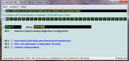

That setting has nothing to do with windows, you are going to create problems for yourself if you start messing with random things
Check the long coding think there may be an option for windows there, it comes under comfort settings, you may be able to just untick the comfort option in the long coding but this will disable all comfort functions inc mirror folding on lock if you have it
Thanks Alied, long coding option, accessing Byte 3 and un-ticking Bit 5 has worked.
Window operation via remote control has been disabled, and no other 'comfort' settings are affected.
That is what I wanted to achieve - to remove the security risk associated with accidental opening of windows.
Thanks Pauly - long coding option worked (and without affecting other comfort settings), so all good.
