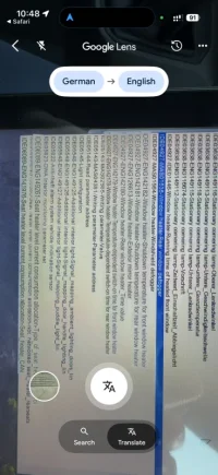

Does anyone know when activating heated screen via VCDS on a 2024 t6.1 if is it just a case of byte 09 front screen defogger being switched to active or is there more?
