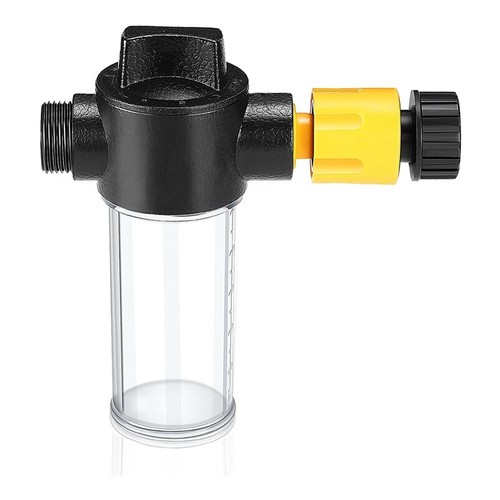

So, I have just bought one of these:
I intent on fully draining my water system before refilling with this little thing plumbed in-line. I'll dose the device with Puriclean and drive around for a day or two before draining tank and flushing.

I filled my device with Puriclean and the little tank wasn't big enough to dissolve the crystals:30D49C77-DA10-469B-A70A-B8752E0D0BA7.jpeg
So I decanted it from the little dispensing tank into a large screw top beaker. (I thought if I put it in a bigger container with a little BOILING water, I could give it a jolly good shake causing it to dissolve)
The above photo was taken just before I opened the lid and BOOM!....... That boiling water mixed with Puriclean builds up to some unexpected pressure!
Luckily, I wear glasses, as I could have had a more serious accident, but I managed to bleached my new Xmas jumper, jeans and much of the kitchen. I also had it over my skin and I immediately rinsed this with cold water. It did cause some very temporary nasty itchy burns on my skin for the morning, which calmed down after a couple of hours.
