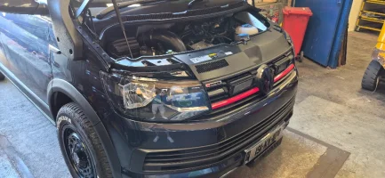

Hi all can anyone tell me is this the turbo boost sensor 03K 906 051 location in t6 transporter 2019 4motion. And how best way to remove it will i need to remove the EGR pipe to get access ?
Looks like the MAP Sensor (Manifold Air Pressure) on the front of the Engine. Was looking at this a couple of days ago on mine, and what a pain it would be to get at. Front end would most likely need to go into the "Service Position" to create enough room to get at it.
If i remove the EGR pipe which is just above it in the picture i think its do able... is that pipe a simple take off and bolt back on when done ?. My second question is that sensor the Turbocharger Boost Sensor P023600
Not certain about the sensor ID, it will measure air pressure from the inlet into the charge cooler so possibly what you are looking for. The EGR Pipe does have gaskets which I believe are "crush" type, and probably need renewing. You should also confirm your Engine code and sensor location. Had a quick read of some info and it looks like there are possibly different locations for "G31 boost sensor"

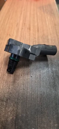

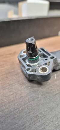

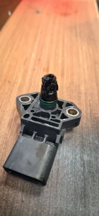

Hi just an update I changed the sensor yesterday I managed to do it without taking off the front end. All in all took me about 30 mins looks to of fixed the fault 👍. It was totally blocked up i could of cleaned and put back😝 but i just replaced it .. what would cause it to block up. I do a lot of short journeys would that be it ?

That’s a serious deposit of sludge, more that I would expect from the PCV and ‘normal’ turbocharger leakage.
Is your engine consuming oil?
The induction manifold must be heavily fouled as well.
