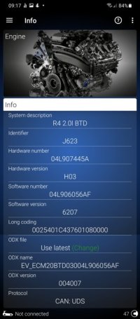

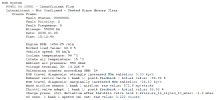

I used obdeleven yesterday and found 2 faults logged, ibelieve the EGR sensor A circuit range is a nuisance message ?

I'm Guessing the EGR is clogged and causing issues?
