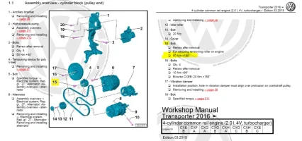

Just picking backup on this tread as about to replace mine.
I was looking at the TSM I have
Transporter 2016 ➤ 4-cylinder common rail engine (2.0 l, 4V, turbocharger) - Edition 03.2019
Which seems later than the above version and it says 50NM and 180 deg and not the 90 deg above. I assume they changed it and I should use this latest.
I don't have VIP access to check if this is still the case, but have got the full set of TSM's for this Edition.
Mine is CXHA on the VIN plate.
Below is the extract,
Thoughts?
So I bit the bullet and paid £6 for one hours erWin access and downloaded all the PDF's, based on VN the van build sheet and the service history.
You also get access to the service issues also.
Just to note some models may well have different torque settings, mine was one of the below:
Transporter 2016 ➤
Transporter 2020 ➤
turbocharger)
Engine ID CXEB CXFA CXGA CXGB CXHA CXGC CXHB CXEC CXGD CXGE CXHC
Edition 08.2023
This confirmed:
15 - Bolt
❑ Renew after removal
❑ For securing tensioning roller on engine
❑ 50 Nm +180°
